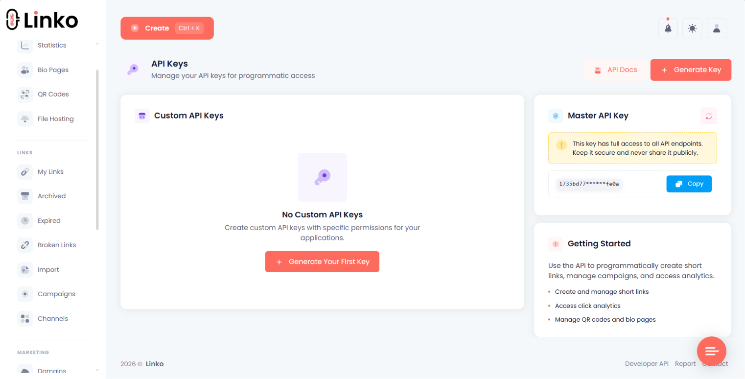

Step 1: Get your Linko API key
Log into your Linko account and navigate to linko.me/user/developers/apikeys.
Your API key is displayed on this page once you’re signed in.
Copy the master key or create a specific key for link shortening. Never commit it to public repositories or share it in plain text.

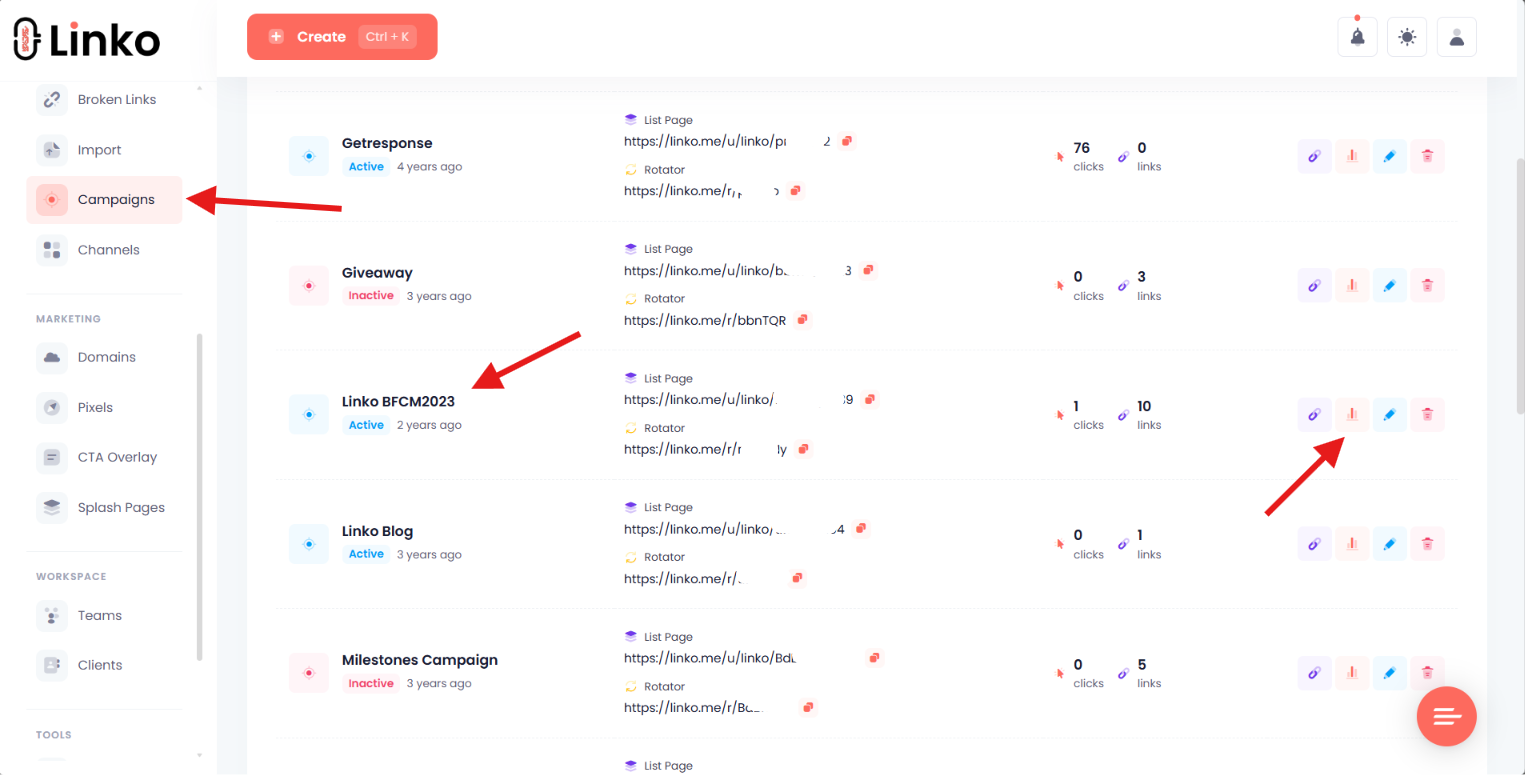

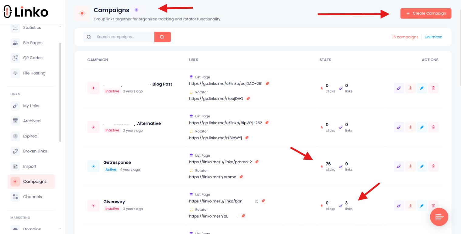

Step 2: Create a campaign for each creator
Campaigns organize links by creator, making analytics dramatically cleaner.
You can create campaigns through the Linko dashboard or via the API.
To create a campaign manually:
  1. Go to your Linko dashboard
  2. Click Campaigns in the sidebar
  3. Click Create Campaign
  4. Name it after the creator (e.g., “creator_username”)
  5. Save and note the campaign ID
For 50+ creators, creating campaigns programmatically is faster. The API endpoint is:
POST https://linko.me/api/campaign/add
For details, see Linko’s campaign creation guide.

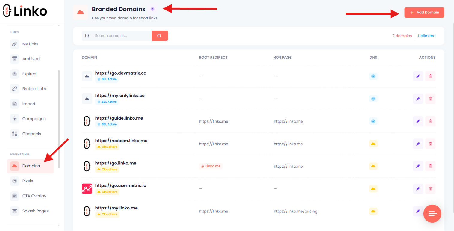

Step 3: Choose your branded domain
Branded domains improve trust and bypass shared domain blacklists.
Common adult creator domains include:
  • allmylink.me
  • onlylinks.cc
  • Your own purchased domain
To set up a custom domain in Linko, follow the branded domain setup guide.
The domain URL (e.g., https://allmylink.me) is what you’ll use as the domain parameter in API calls.

Campaign organization
Use clear naming conventions for campaigns.
Recommended pattern: {creator_username}_{platform}
Examples:
  • jane_doe_reddit
  • jane_doe_instagram
  • jane_doe_tiktok
This lets you analyze which platforms drive the best subscribers per creator.

Treat your Linko API key like a password.
  • Never commit it to version control
  • Don’t share it in screenshots or logs
  • Rotate it if you suspect compromise
  • Use Airtable’s secrets feature if available on your plan
If your API key is exposed, regenerate it immediately from the Linko dashboard.

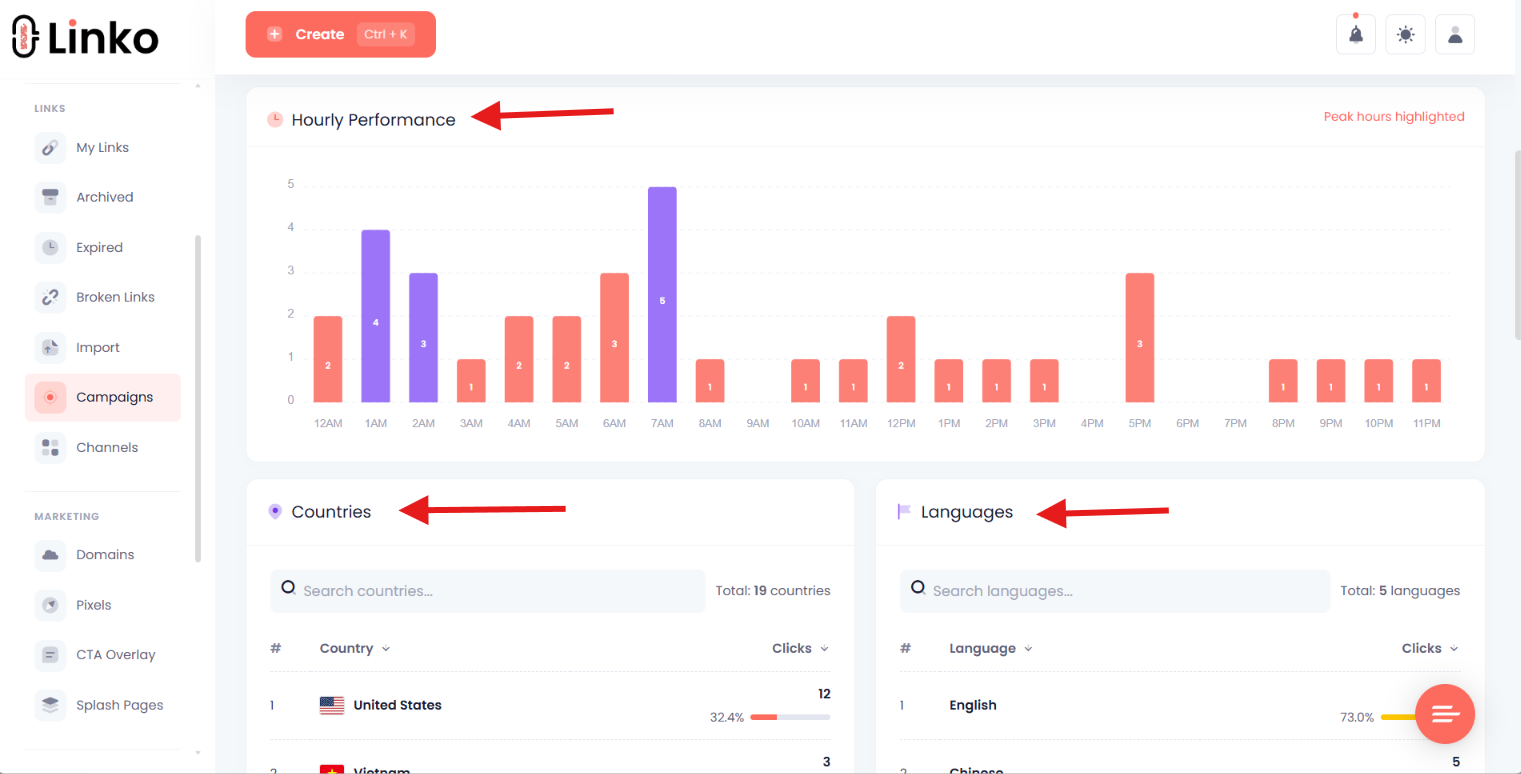

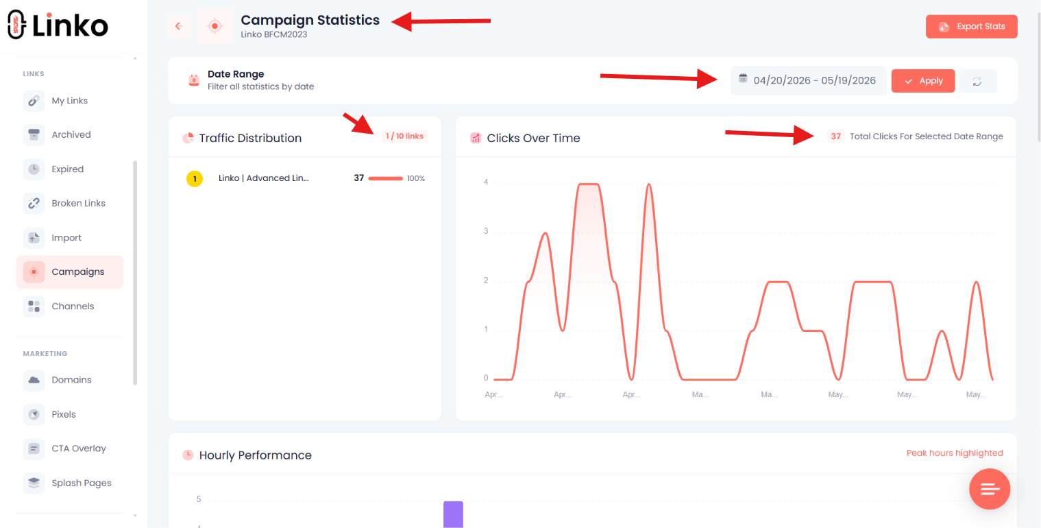

Tracking link performance
Each generated link is tagged with its campaign automatically.
To see performance per creator:
  1. Go to your Linko dashboard.
  2. Then navigate to the campaigns page.
  3. In front of each campaign, you will see a stats icon; click on it.
  4. You will be redirected to the aggregated stats dashboard for all links inside the campaign.
  5. You can view clicks, hourly performance, geography, devices, language, and referrers.
This data tells you which creators convert best on which platforms. For more on link tracking, see how to track links for free.

“Error 1: API key invalid”
Your API key is wrong or expired, or your plan doesn’t include API access.
Solutions:
  • Verify the key from your Linko developers page
  • Check that your plan includes API access (Pro, Business, or Agency)
  • Ensure the key isn’t surrounded by extra spaces or quotes

“Domain not found”
The branded domain isn’t configured correctly in your Linko account.
Solutions:
  • Verify the domain is added in your Linko dashboard
  • Check DNS propagation if you just added it
